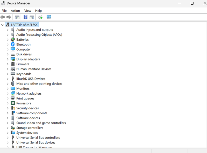

I have visited the device manager and there is no camera here i also have scanned for the hardware device but didnt get the camera or imaging devices how can find pid and dev numbers now for my camera Screenshot 2025-02-06 235951.png
see if the camera shows up when you select "Show Hidden Device"
No
You are running LibusbK and i suspect it may be interfering with the  HP camera system which runs off of the USB bus.
if you used Zadiag to install the driver then use it to uninstall.  I used Zadiag to install USB crypto device back when USB mining was still paying and I had trouble with other USB peripherals.
If the original winusb drivers cannot be found you probably need to do a cloud restore.
