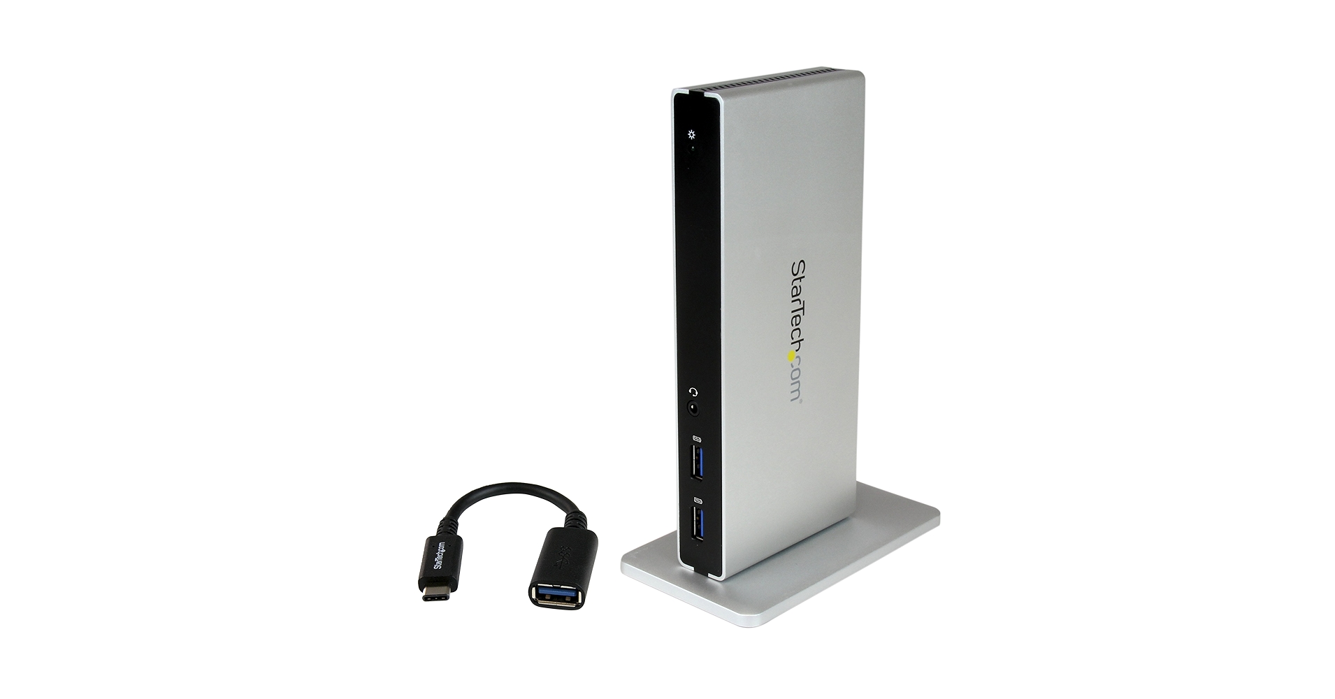

The docks are obviously not going to work with the new laptop. m6-aq105dx is the model number and it has a USB-C port which I am sure you have not experienced before. It is the little oval port. Your best bet to come as close to the dock experience is a USB-C port replicator with dual video connections. Right now you have two HDMI cables coming out of the dock going to two monitors connected with DVI-D?
https://www.amazon.com/StarTech-com-USB-Dock-Monitor-Replicator/dp/B01IR0OG5Y/ref=sr_1_1?ie=UTF8&qid...
Something like the above would work. You can connect the two DVI monitors direct to the port replicator. This will not charge the laptop so you will have to use the laptop charger, but will allow connection of mouse, keyboard and two monitors. You can find similar USB-C devices with dual HDMI or a DisplayPort and an HDMI...all kinds of options.
