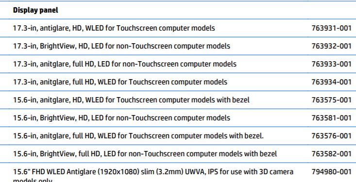

i want upgerad my laptop lcd, bu my device resolution is 1360x768 ,now i need 4K resolution or UHD 3840×2160 pixel, cen i change my device lcd and update it????

I see you need help in upgrading the Display, onHP ENVY Notebook - 15-k211ne. Don't worry as I have a few suggestions which should help you.
After reading your post, I did go through the Maintenance and Service Guide of your product and found that the maximum display can be upgraded up to Full HD display panel.
Hope this helps! Keep me posted for further assistance.
