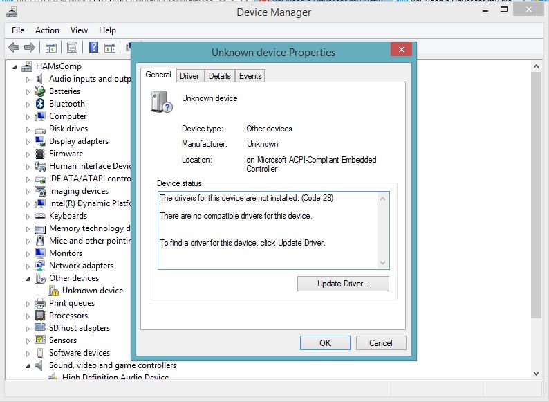

11-04-2016 12:42 AM
Hello!
Success on 2 fronts! WiFi is restored. Paul your link worked.
Also the PCl controller driver link worked. Great!
The unknown device is still unresolved (although the other two were much more important to me).
I already have the 3D Driveguard driver installed that you suggested Paul.
Below is a screenshot of the Properties of that Unknown Device.
Thank you both Banhien and Paul for all your help so far.
Graham
11-04-2016 06:50 AM
You're very welcome, Graham.
The only way to nail down that last device, will be for you to post the hardware ID for it as banhien recommended.
Here are the written instructions to find the hardware ID:
Go to the device manager and click on the unknown device needing the driver.
Then click on the Details tab at the top of the unknown device window.
Now you will see a Property drop down list, and it will be set to Device Description.
Drop down on that list, and select the 3rd item (Hardware ID's).
Post the top string of characters that you see in the window.
11-04-2016 07:03 AM
Hi, Graham:
Here is the link to the driver you need for that device...
This package contains the driver that enables the Intel Virtual Buttons to be used with supported notebook models that are running a supported operation system. Intel Virtual Buttons software allows the virtual buttons to adjust correctly when the screen rotation of the tablet is changed after the system is connected to or disconnected from the docking base.
11-04-2016 09:07 PM
Hi,
I dowloaded the driver you suggested. The Unknown Device still appears in Device Manager.
Hardware ID's:
ACPI\VEN_INT&DEV_33D6
ACPI\INT33D6
*INT33D6
At the bottom of this message is a screenshot of what the Device Manager window looks like now.
Also, now it seems that an Audio driver is missing. I don't think that was there before.
(Hardware ID: HDAUDIO\FUNC_01&VEN_8086&DEV_2808&SUBSYS_80860101&REV_1000)
