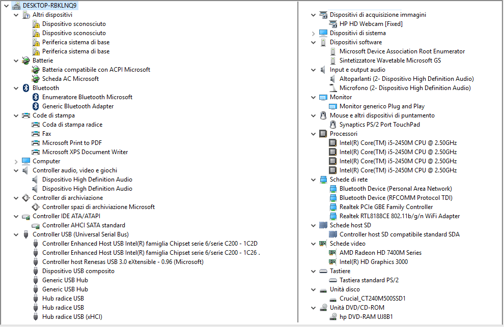

4. Here is a list of device manager:
I was able through updates to get most of devices recognized except for 4 devices which I will list here.
ACPI\VEN_HPQ&DEV_0004
ACPI\HPQ0004
*HPQ0004
 I believe this is "HP 3D DriveGuard"
USB\VID_138A&PID_003C&REV_0086
 I believe this is "Validity Sensor Driver"
PCI\VEN_197B&DEV_2393&SUBSYS_167C103C&REV_30
PCI\VEN_197B&DEV_2393&CC_088000
 I believe this is "Base System Device"
PCI\VEN_197B&DEV_2392&SUBSYS_167C103C&REV_30
PCI\VEN_197B&DEV_2392&CC_088000
Where do I find and download all HP drivers, software and addons" when HP offers only those up to  Windows 8.1?
Drivers/software like: Chipset and mostly HP Finger Scan Security?
How to find out what those 4 missing devices are and how to solve this issue?
