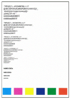

The printer cleans the printhead and prints a test page. This can take a few minutes to complete.
Examples of the Test Page
Examine the print quality on the test page.
If the print quality is still unacceptable, touch Yes to clean the printhead up to two more times.
NOTE:
Printheads that are badly clogged might require another full cleaning cycle. Wait at least 30 minutes before cleaning the printhead again.
If the print quality is acceptable, touch No. You are done.
