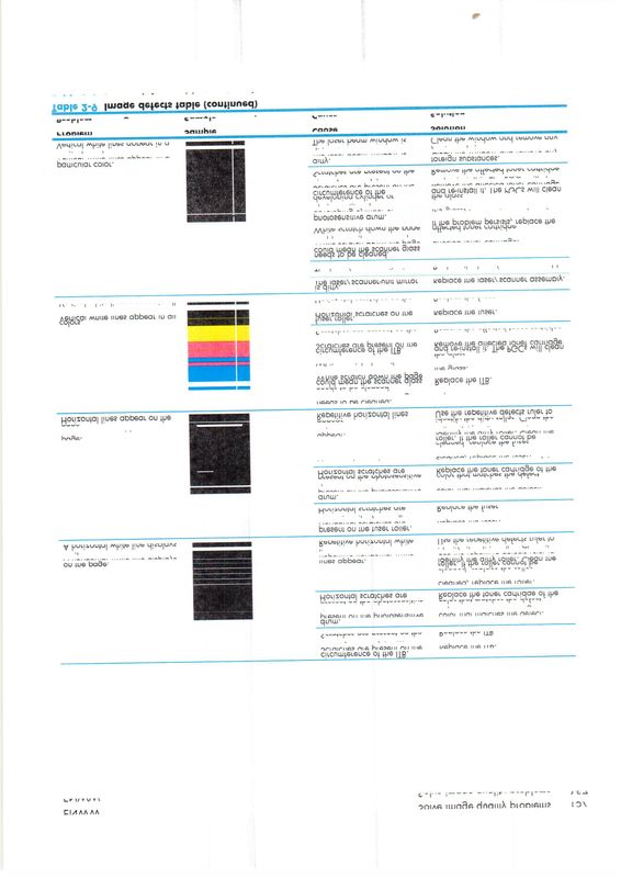

First few pages have vertical blck lines.
Second page of duplex printing illegible, prints overlap lines and are back to front.
I have tried replacing the black cartridge but it did not help.

EG of bad double sided print MFP M570dw_Page_1.jpgEG of bad double sided print MFP M570dw_Page_2.jpgEG of bad double sided print MFP M570dw_Page_3.jpg
Thank Repairatrooper.
Interesting; when I used tray 1 (like a manual feed itt was fine. Then I tried tray 2 again and the second page was fine apart from black lines on both.
