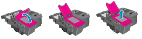

  • Open the cartridge latch, and then pull the cartridge up and out of the slot.
  • Removing the ink cartridges with latches from the carriage
