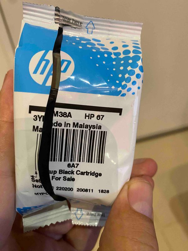

My printer model is "HP DeskJet 2700 series" as reported by the HP app on my macbook. I would realy apreciate your help here. I bought original ink cartridegs sealed in the HP bags online and it does not work. Have to drive around town now to do my printing 😞
What is the exact error you are receiving?
Let me know!
This is what I see on the printer and the cartridge I bought from Lazada in Thailand.
