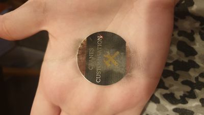

This printer is really not good at anything other than printing on or scanning with plain paper.
I have tried to use glossy sticker paper and changed the settings as required, however the ink is smudging on stickers and they look terrible. I don't not want to delete files like last time when I got told to as this just disconnected the printer completely.
I have already factory resetted my laptop and reconnected the printer to it and still smearing. Help!

Hi it is glossy sticker paper I am trying to use. Your comment says this is supported but it is smearing. Can you recommend a supported sticker paper please? Thanks for your reply.
In regards to the bit where I said I got told to delete files, this was not on this forum.
Thanks 🙂

Also the printer works but the ink is just smearing.
