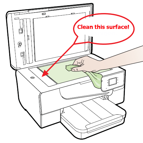

So point 2) applies
this is the glass for the ADF.
And the black cartridge is OK.
Andr-1611
