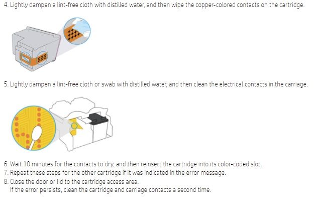

OK, neither of the cartridges shown are Instant Ink Ready cartridges, so the message is spurious. It may be possible to use the cartridge by cleaning the cartridge and printer electrical contacts as shown in the document here. I have highlighted the relevant section below:
The cartridges do have a warranty, see the document here for information. To get warranty coverage you will need to go to the Contact HP page, then enter the serial number information for your printer. In the comments section mention you need a replacement color cartridge, mention the warranty date on the cartridge and that you have verified the cartridge is at fault be replacing it with the old cartridge.
