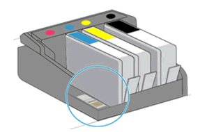

  • Remove and reinstall the cartridges to ensure proper seating.
    1. Turn the printer on.
    2. Open the cartridge access door and wait until the carriage stops moving.
    3. Remove the affected cartridges.
    4. Inspect them for any protective tape (if new) and check for dirt or ink buildup on the chip.
    5. Reinsert the cartridges firmly until they click into place.
Clean the Cartridge and Printer Contacts
  • Use a lint-free cloth slightly dampened with distilled water or isopropyl alcohol to clean:
    • The gold-colored contacts on the cartridges.
    • The carriage contacts inside the printer.
  • Let them dry completely before reinserting.
