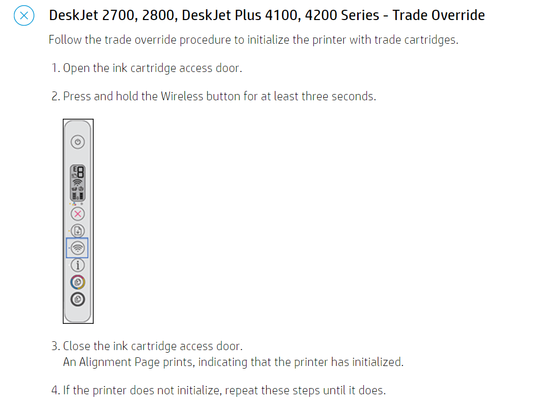

I’m sorry to hear you’re running into this problem with your HP DeskJet 2720. The printer is currently locked in Setup Mode, and you do not have setup cartridges.
I would request you to please insert the original HP cartridges in the printer and try the steps shared in the image below; this will help bypass the setup error and will help resolve the issue.
I hope this helps.
