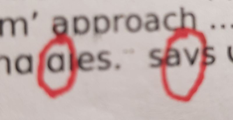

Despite having cleaned, aligned and even *changed* the black cartridge I still get poor print quality (e.g. a word will be 'fuzzy' or have bits missing [like the bottom of a 'y' or the top of a 'd']. See photos). Drivers / firmware all up to date.
I don't know what to try next?
Any suggestions very welcome.
Thanks, Nefeco.
missing bottom of wordmissing bottom of wordbottom of 'p' missingbottom of 'p' missing'smudged''smudged'top of 'd' & bottom of 'y' missingtop of 'd' & bottom of 'y' missing

This indicates a hardware issue with the printer. I have sent you a Private Message with the details regarding the service options for your printer.
