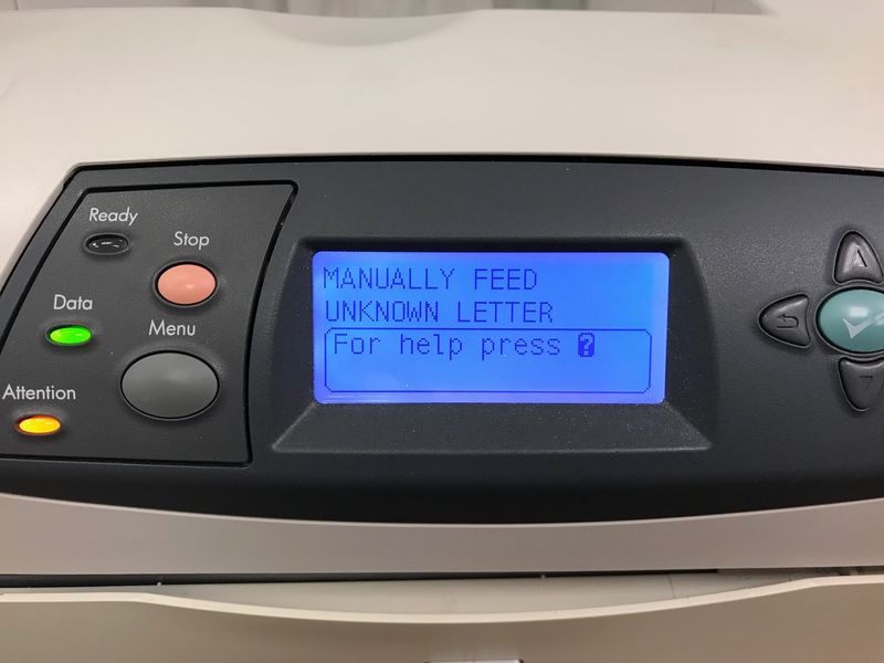

After updating to Universal Print Driver v6.7.0.23989, users are prompted with "Manually Feed Unknown Letter" at the printer console. Multiple users, multiple printers. Settings look good, no other changes were made other than the driver update itself. I compared settings on a different Print Server still running with an older version of the Universal Print Driver (settings are identical). Not sure what I'm missing. Any thoughts?

As of this post, v6.7.0.23989 has been available for download for about a week. I tested this new driver in one of our smaller offices which has Laserjet 4350n & P4515n models for the most part. No issues with the older v6.5.0.22695 driver. After doing a basic driver update on the print server, we are seeing the attached message on the printers (no errors or message on the Windows 10 OS). User can hit the "Check-mark", and the job will print out of Tray 2 paper tray normally. We see this at every computer on both models of printers.

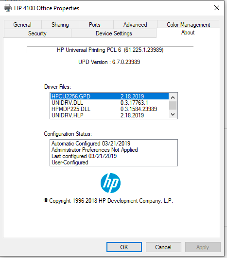

I have two HP 4100 printers. I recently insatlled a new Windows 10 64 system on one computer to overwrite a previous Windows 10 32 bit system. I installed the latest driver from HP. When I try to print, I get the message "Manually feed unknown letter." Both printers cause the same error in this machine. Printing from other machines to the same printers work fine, so it must be this new driver, Any Ideas?

We have the same issue on HP 4015x and other printers. With the v6.4.1 everyting prints correctly. Switching to the v6.7.0 driver causes a prompt at the printer for "Manually Feed Unknown Letter". Settings are the same between both drivers and this has been installed multiple times on two different DEV print servers. Seems like a driver issue that needs to be fixed.
03-27-2019 09:24 AM
Unfornately I don't have an update. We are still living with the issue waiting for HP to address this. End users are annoyed because they were use to walking up to a public printer and their job had finish printing. Now they have to hit the Check Mark and wait for their job to print while they are standing there. So we have put a hold on updating the HP Universal Print Driver on our other print servers in 14 other offices. Van.
