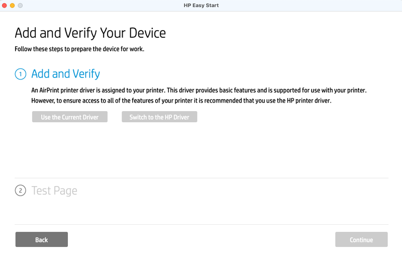

So, when selecting "Switch to HP Driver" the installation procedure stops and "Test Page" is not selectable:
