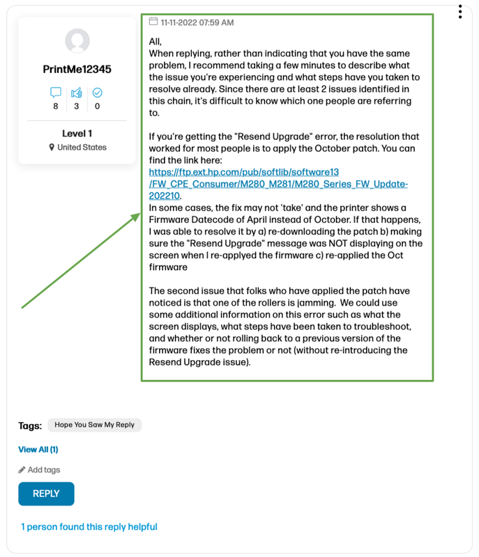

Please follow steps from the next link with a workaround from user @PrintMe12345
HP Color LaserJet Pro MFP M281fdw Resend Upgrade error
https://h30434.www3.hp.com/t5/forums/forumtopicprintpage/board-id/Software/message-id/269726/print-s...
October patch. You can find the link here:
https://ftp.ext.hp.com/pub/softlib/software13/FW_CPE_Consumer/M280_M281/M280_Series_FW_Update-202210...
Full answer screenshot:
Hope that steps could help you !

Thanks!  The link you sent seems expired but it helped me search for the right driver and I found another ftp link for the old firmware that did the trick:
Received this from this post:
Printer hung up with resend upgrade warning. Lase jet pro MF... - HP Support Community - 8519806
