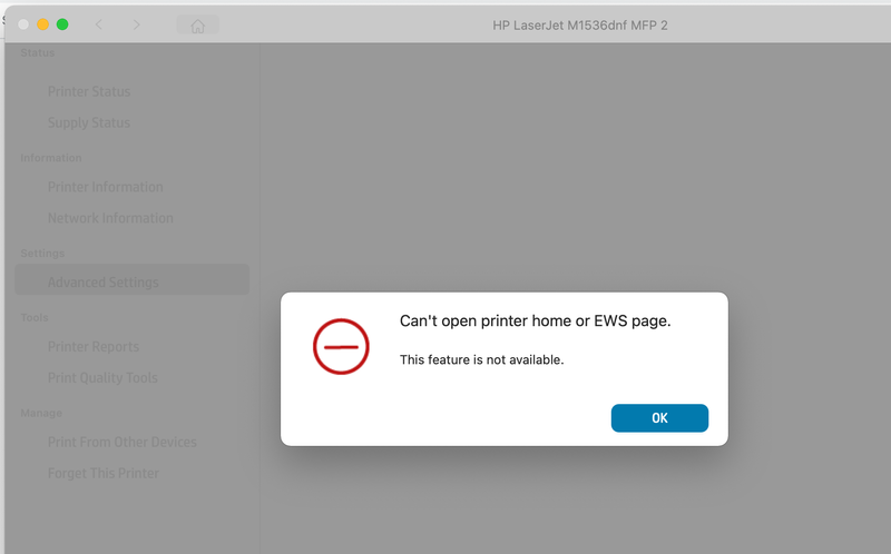

- When I went into the Smart App and clicked on advanced it gave me an error message (attached)

Thank you for the detailed information. Here, the Mac is detecting the printer. It means the communication between the devices is fine.
Kindly install the printer using the AirPrint driver as mentioned in my previous post let me know how it goes.
Keep me posted.
