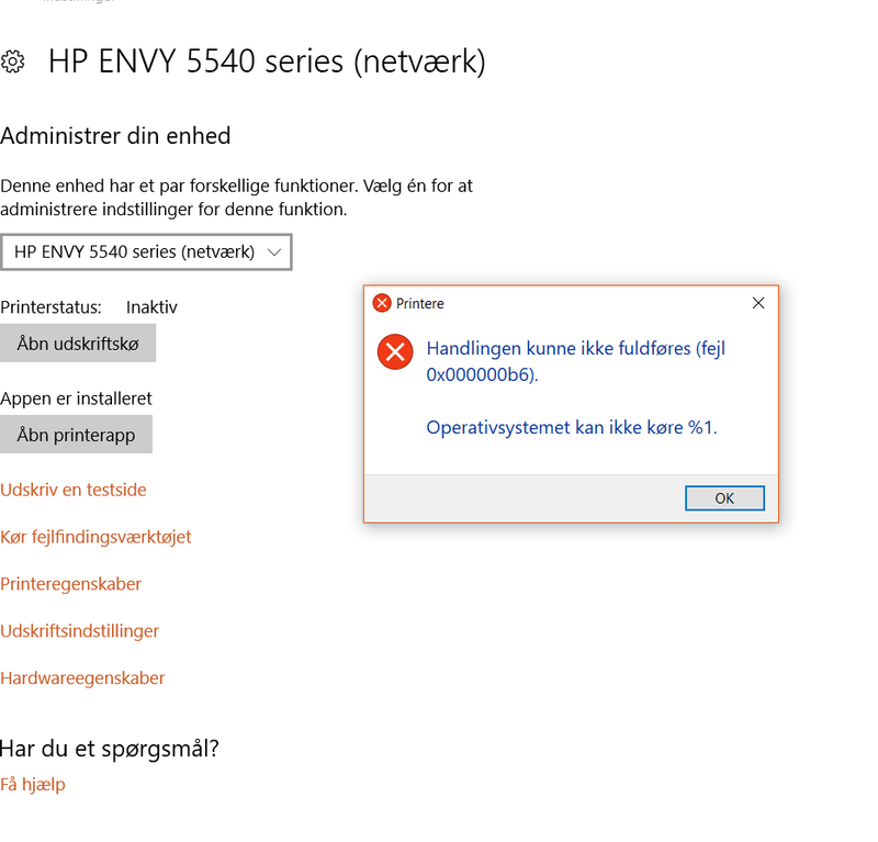

Hi!
Oh,...I was too happy too soon Smiley Sad
I left the printer working, a few days later trying to print from web this is what I get:
Chosen printer is not accessible or not installed correctly.
Trying from Excel I get this:
The file can't be printed because of an erorr in printer (network).
And some silly messages that I reckon don't make sense in this case
If I choose printers and scanners in settings, choose the printer saying "not connected" and choose administrate
and from there try to print a test page, this is what I get:

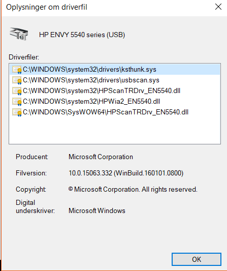

This is what looking at the printer in device manager says:
Hardware unit is not connected a the moment (code 45)
(it is online and has excellent connection to wireless acc. to printer )
This is the information about the driver :
This is information about the events:
I am completely lost now - I have no clue what to try next..... Woman Sad
