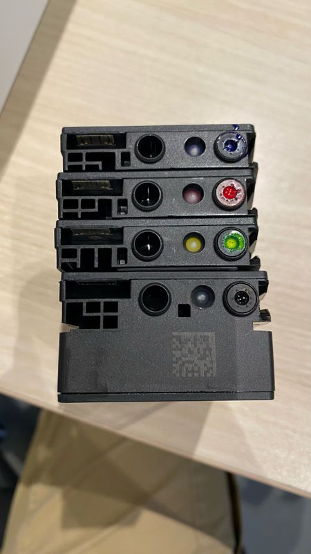

A few week ago I received a new printer the HP OfficeJet Pro 9730e.
At the start of the setup installation I received an error.
It said that one of the Setup cartirdges (the yellow one) was leaking.
So I checked it but nothing was wrong with it. I unplugged them all a few times but the error continued after that I tried new unused cartridges (not SETUP cartridges) but I needed to do it with setup cartridges so it didn't work either, I decided to reset the printer and start from the beginning. Now I got the error that I need to use unused cartridges. That means that the setup cartridges I have no longer work. I decided to contact HP Support, I have been calling with them several times but with no success. They send me new cartridges but those aren't setup cartridges. I can't seem to bypass this error message.
Does anyone know a solution to bypass this or to make my new cartridges into setup cartridges.HP Printer 1.jpgHP Printer 2.jpgHP Printer 3.jpgHP Printer 4.jpgHP Printer 5.jpgHP Printer 6.jpgHP Printer 7.jpg

Hi, thanks for your reply. I have earlier called HP Support again, someone very helpful has found  a solution.
So on the printer screen u see * and # to bypass it I tap         * # * *     I open the printer access door and close it again. This method helped me bypass the setup cartridges and now the printer is fully functioning.
