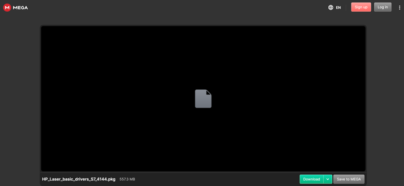

Ok, if that doesn´t work you can try with a Laserjet basic driver:

Thank you for the follow-up, but the solutions will not solve my issues. My printer continues to only to keep my desk from floating away. 😄  The first link is a third-party file share system, not with the HP company, and I must not download a file from an unverified source on my work device.  The second solution requires me to install another application that our legal department will not approve.
