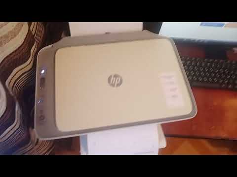

It`s not the Ink "PROBLEM". I`m using original ink refill kit, bought from this seller (trusted by me).
I`m using original cartridges that came with the printer. (with reused HP chips)
The problem is that, each print job is canceled by the printer itself (while printing), with error E0, together with low ink level indicator blinking on display and the Ink Alert light is blinking at the same time.
And it`s not a cartridge problem or bad contact / contacts surface problem.  I`ve checked.
When printer is restarted without touching cartridges, even without opening cartridge access door, all errors goes away !
It should work, but it`s not. It just forces me to by new cartridges.
So what is wrong?
Please reply.
This video is demonstrating error E0 while printing with refilled cartridges':
https://www.youtube.com/watch?v=U_DtJVvnIpM
HP declare that (quote) :
printers are intended to work only with cartridges that have new or reused HP chips or electronic circuitry.
Reused HP chips and electronic circuitry enable the use of reused, remanufactured, and refilled cartridges.
Video show that using refilled cartridges' actually is not possible due to error E0 triggered while printing.
This error forces users, who are using original refilled cartridges, to buy new cartridges.
The problem is that, each print job is canceled by the printer itself (while printing), with error E0, together with low ink level indicator blinking on display and the Ink Alert light is blinking at the same time, while using original Refilled cartridges with original ink. This video is created ...
