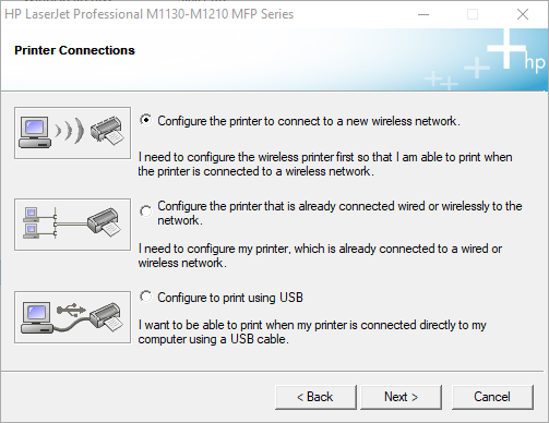

Hello,
As I faced weird problems while scanning recently  using WIA (HP Scan and capture gave results in black and white, while I selected colours…on multiple computers running Windows 10), I decided to uninstall and reinstall the driver for my MFP printer HP LaserJet Pro M1217nfw.
I first uninstalled the full driver solution (in Control Panel\All Control Panel Items\Programs and Features).
I also uninstalled the printer driver packages in Control Panel\All Control Panel Items\Devices and Printers (under Print Server Properties) + uninstalled the scanner driver packages in the Device Manager under Imaging Devices.
Finally I removed the remaining obsolete drivers in C:\Windows\System32\DriverStore\FileRepository\ using the application Driver Sore Explorer
Then I rebooted and tried to reinstall the Full Software Solution (driver+software) using the option Configure the printer to connect to a new wireless network:
When it asked to connect the USB cable:
I connect the USB cable, the installer display "Wireless Configuration" for a few seconds and then fails (exit without any message):

If I select another option (like Configure to print using USB), the installer doesn't fail and install the drivers and software.
This issue only occurs if I select option Configure the printer to connect to a new wireless network. … and I need to use my MFP printer on my WiFi network 😕 I didn't change anything in my network.
