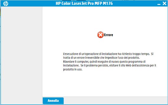

Hi, I can't install the driver for my Laser Jet Pro MFP M176n on Windows 10 (64 bit).
Everything was fine since few weeks ago, then suddendly I couldn't print anymore (maybe cause of a Windows update?).
I tried to reinstall the printer (removed it from the devices first), but I always get the same message, it's in italian, the translation is something like this:
"Performing an installation operation took too long. This is a fatal error that prevents the use of the product."
I can install the printer by using the Windows settings, but after the installation is done, it seems that Windows does not recognize it anyway, and if I try to print I get immediately an error.
HP Smart can't find any printer to add.
HP Print and Scan Doctor recognize the device, but in the next step says the printer is not connected and I get this message:
"Unable to communicate with the selected product."
I already tried with the universal drivers, tried using another USB port and another USB cable too, nothing changes.
I don't understand the reason why if the printer is not connected, I hear the USB connected/disconnected Windows sounds when I turn it on/off.
What else can I do? 😭

Hi, thanx for the reply...
Nope, it did not work... 😕
The only thing that has changed is that before the installer asked me to connect the printer before going on, while now it doesn't ask. But in the end I always get the same hateful message.
I can't update the firmware because Windows still does not recognize the printer.
I don't know if this can be useful, but I did a Google search and I have found on a Microsoft forum that someone else (but there were many others marked with the same question) with a similar printer (MFP M125) had the same problem.
After all attempts have failed, the Microsoft operator said that probably it's an outdated driver due to a Windows update. The discussion ends this way, without any other solutions.
I've seen that the drivers for this printer have never been updated since 2016 (and I think it's really a long long time)...
EDIT
I tried to configure the printer as a net printer (at first didn't think about because the router is at the other side of the house, but I think this was a last ditch effort) and now it works.
Can this help you to understand why it doesn't work with USB?
