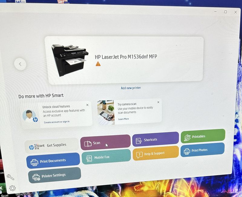

First you really didn't answer my question but went and had me uninstall the official HP Full Feature Software and install printer software using HP Smart which doesn't install the same software. First to scan you have to open the HP Smart app:
New Scan Software.JPGSo there's no link anymore directly to the HP Scan app that we used to have on the old computer that's part of the full feature software. Next if we click Scan we get this:

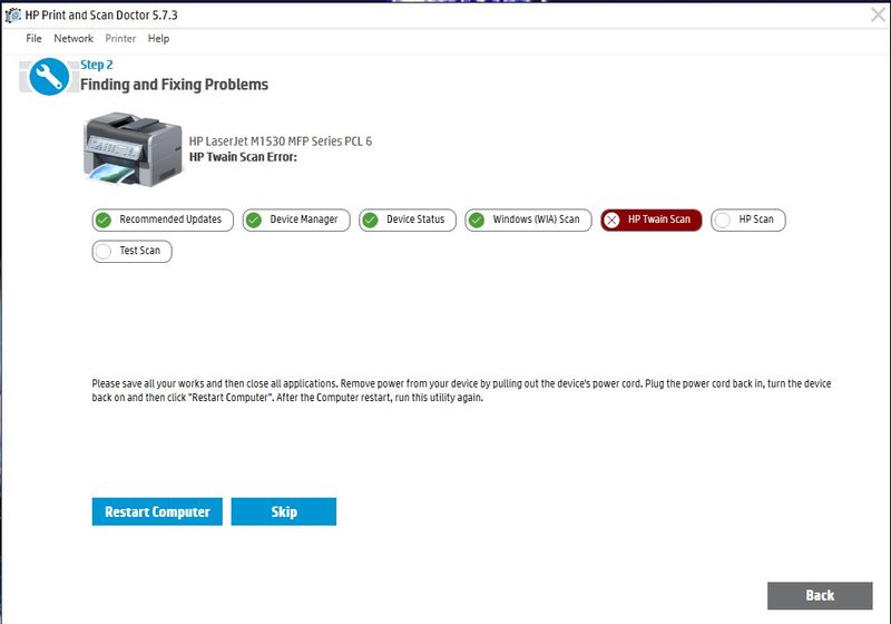

The HP Print And Scan Doctor makes a recommendation to "Please save all your works then close applications. Remove power from your device by pulling out the devices power cord. Plug the cord back in, turn the device back on and the click "Restart computer". After the computer restart, run this utility again." however after doing that 2 - 3 times it made no difference and the HP Scan software could still not communicate with the printer:
