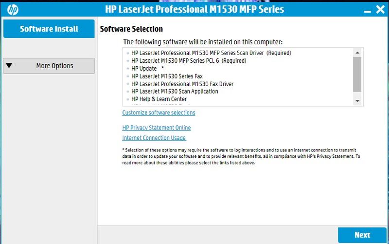

During the install of the full version software it says "The following software will be installed on this computer" and in the list is "HP Laserjet M1530 Scan Application" which is certainly not installed:
