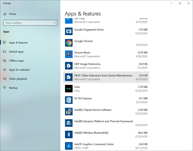

Working on step 9. Look for HP Printer driver. If you see it Click on it and click Remove at the bottom.
I get an error that
Unable to remove HP ENVY 4500 Series Class Driver, x64, Type 4 - User Mode driver.
The specified driver is currently in use.
In the attached images you can see
1. that I  removed the printer.
2. The error
3./4. What I clicked from the drivers menu
5. That there are no HP apps on the computer.
I have already tried rebooting then removing the driver.
Thanks,
-Brian
