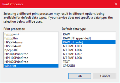

01-26-2022 06:32 AM
Hello and thanks for your return,
In order to palliate this incident, try the following solution:
- On the keyboard, press the Windows and R keys simultaneously. The Run window opens.
- Type control printer, then press Enter. The Devices and Printers window opens.
- Right-click the printer icon, then click Printer properties. The Properties window opens.
- Click the Advanced tab, then click the Print Processor... button.
- Select winprint as the Print processor, and select RAW [FF auto] as the Default data type.
- Click OK, then Apply, and then OK.
- Try to print.
Do not hesitate to contact us in case of need.
Best regards,
01-26-2022 10:44 AM
I tried that yesterday, but gave it another go just now.
Chose Winprint and Raw, yesterday, today made your choices ... Got a bytestream ZIMP= XXXX
Went back to HP1020PrintProc and IMF, got a properly encoded page with graphic, but it still just kept printing.
