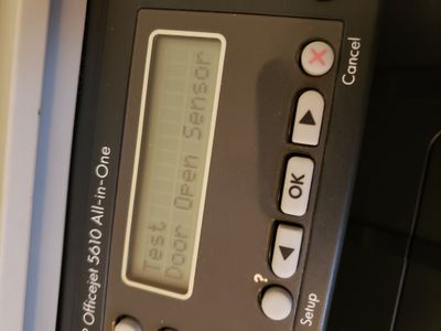

Somehow my printer is locked into a weird mode. The normal UI and function of the buttons and LCD screen are gone and replaced by a screen constantly saying things like "TEST. OPEN DOOR SENSOR"
Out of ideas I went ahead and opened the ink cartridge door. It liked that, and responded with another request. It asked me to press the power button. I did that (does not turn the printer off FYI), then it wanted me to press speed dial button. At this point it became clear that I am function testing all the buttons and sensors. Problem is I have no desire to do this, and I'm not sure exactly how we got here, but I was entering all kinds of codes into the keypad last week to get some diagnostic pages printed. I think something happened and it is now stuck in diagnostic purgatory. HELP ME!
I did a whole bunch of resets already, including a level 9 scary one. But the stupid message is still there. It will print sometimes, other times it thinks the ink cartridges are fake (whisper "THEY ARE!"). I managed to get the message to disappear from the screen earlier today but I was button mashing and the change did not last.

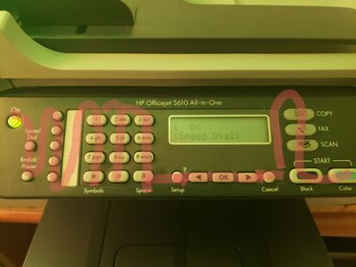

Since ink cartridges are frequent causes for faults and errors, I opened the cartridge door, the cartridges parked over to the right and I removed both. I power cycled via the power cord. I was greeted with the same power-on message "0 TEST OPEN DOOR SENSOR". I opened the door, then closed it, the printer showed "0 ON <SPEEDDIAL>". I pressed the ON button, then SPEEDDIAL button the printer began leading me across the entire keyboard. After each button is pressed the display updates telling you which button to press next. See OP for a picture of the button order. Once you reach the final key, which is one of the copy buttons, press it multiple times. Thats the key bit that took a lot of trial and error to figure out. That finally released my printer from test mode jail and the printer booted normally and the UI was back to normal. I installed the previous cartridges and an alignment page printed, was scanned and I'm back in business. Printer prints and scans normally now.

In the picture I attached previously, do you recognize what is displayed on the printer screen? Is this a known mode for this printer and if so there has to be a way to exit it. This all started after I was attempting to diagnose missing colors in my printing, and I found a post that gave me some codes to enter into the keypad on the front of the Officejet 5610. As I recall the codes were a series of 3 or 4 numbers, followed by pressing 2 buttons at the same time. (I think the 2 buttons were * and #). It was after entering several of these codes and restarting the printer that I first saw this test mode come up.
A couple times I have been able to exit this test mode, but only by accident. But it comes back on the next power up. The way I was able to exit the test mode was to follow the prompts on the screen and press every button on the printer in the order they are presented on the screen. Here's a picture of the route it takes you, starting on the left with the power button.
After doing this I then started mashing buttons and somehow escaped the test mode. The normal display came on and I used the printer as normal for a few days. But then when I turned it off and later back on again, the test mode was back. I have not been able to replicate my escape from test mode since.

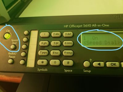

No matter how I have tried to reset the printer, including all of your suggestions, it still boots up to this TEST screen. It responds to nothing, except pressing all the keys in order. See how it says "ON" and "Speed Dial" on the screen? Those are the first two button on the printer starting at the left.
If I push those keys it prompts you for the next key in the sequential order. Very strange.
