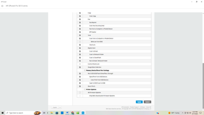

I just spent 2 hour 43 minutes and 23 seconds on the phone with a gentleman from Support and after much work he was able to direct me on how to correct this problem (I hope). It DOES appear that the issue is gone.
1. Open the  HP Smart program (download the program if you don't already have it, start here https://123.hp.com/us/en/ )  Your printer must be ONLINE as shown in the picture below
2.  Click on Printer Settings (bottom left)
3 . Advanced Settings (Left side menu- under SETTINGS)
4. Settings (far right of grey Horizontal Menu) (pictured below)
5.  Security (pictured below)
6. Administrator Settings (pictured below)
7. Scroll to the very bottom of the list of settings
8. UNCLICK ALL FIRMWARE UPDATES
9. APPLY
That's It!!  You shouldn't have to worry about this problem again!
If you know the ip address of the printer, type it in the url of a browser.  If it lets you in, then start at #4 on RICKEZ comment to complete.
thanks! seems to be okay now
