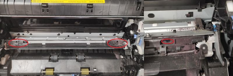

I have a new firmware (FutureSmart Bundle Version 3.9 - HP LaserJet Enterprise 700 color MFP M775 Series FIRMWARE) - it does not solve my problem, but has created another problem. I have a question https://h30434.www3.hp.com/t5/Scanning-Faxing-Copying/HP-LaserJet-700-color-MFP-M775-The-lines-are-q... which indicates a problem when scanning. This is on the firmware FutureSmart Bundle Version 4.11.2.3 - HP LaserJet Enterprise 700 color MFP M775 Series FIRMWARE. When printing from a computer, color pages or black and white - there are no problems with stripes and color doubling.
I tried FutureSmart Bundle Version 3.9 and now when printing a color copy from a computer, the color is doubled. The black-and-white copy is excellent. Scanning with stripes.
Please help! Just please do not write to do a full calibration, partial calibration, reset the printer to factory settings - it does not help. I do not know what else to try...
08-30-2022 07:23 AM
If you have issues with a scanning you might have a defective scanner control board or defective scanner.
For issues with alignment when printing clean calibration sensors first and calibrate the printer.
09-01-2022 03:48 AM
In general, it's all about ITB ... I put it from another printer, everything prints fine... the printer also constantly wrote that Install a new image transfer unit. Although it is inserted. I put 5225 in the printer, I will test it. The problem with the scanner will be in another topic. Thanks.
