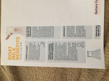

Hi. I disabled the fax confirmation but it didn't solve my problem. I used supply computer support for schools and usually these problems are printer driver related. I was surprised that a new driver didn't solve my problem.  Here is a picture of the graphic as printed and one as seen in print preview. You can see where it makes the graphic larger and then cuts it off.  Any more ideas?
