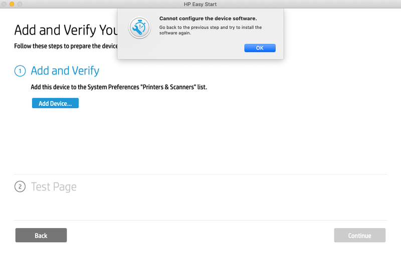

Hi @KUMAR0307
thanks for the msg; however, The HP3545 link provided asks you to download HP Easy Start & Printer firmware.
1) HP Easystart: I follow the steps, it installs the driver and in the last screen where it asks to add and verify the printer , I get an error message to go back instal the driver. this is after I have received a message that the drivers are installed correctly. PFB screen shots
Screenshot 2019-09-18 at 6.16.22 PM.pngScreenshot 2019-09-18 at 6.16.51 PM.png
2) Printer firmware updater offers no updates
