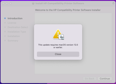

HP's LaserJet Pro P1102w printer drivers (download) fail to install on macOS 12.0.1 or later. Attempting to install them displays the error:
This update requires macOS 12.0 or earlier.

The problem is due to the Distribution script in the installer. It looks like this:

The script is checking for 12.0 instead of 13.0.
The workaround is described in a macrumors thread: run these commands in Terminal:
curl -o ~/Downloads/hpdrivers.dmg https://updates.cdn-apple.com/2020/macos/001-41745-20201210-DBC9B46B-88B2-4032-87D9-449AF1D20804/Hew...
hdiutil attach ~/Downloads/hpdrivers.dmg
pkgutil --expand /Volumes/HP_PrinterSupportManual/HewlettPackardPrinterDrivers.pkg ~/Downloads/hp-expand
hdiutil eject /Volumes/HP_PrinterSupportManual
sed -i '' 's/12.0/13.0/' ~/Downloads/hp-expand/Distribution
pkgutil --flatten ~/Downloads/hp-expand ~/Downloads/HP_Drivers_12.pkg
rm -R ~/Downloads/hp-expand
Then open the newly-created HP_Drivers_12.pkg and install it.

I have the P1102 and MacOS 12.1 with this same issue. I ran the script as suggested in the MacRumors threat (as it seemed to make sense). I got past the install warning and it claims to have installed. However, it does not show up in my printer list or appear to be working.
