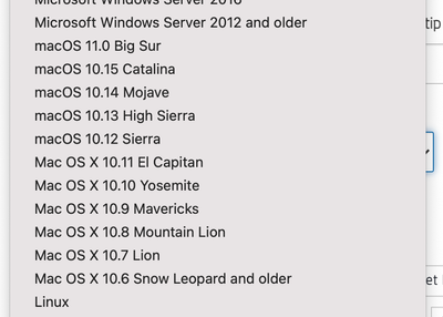

PS The forum software doesn't yet list macOS 12 as an option:
