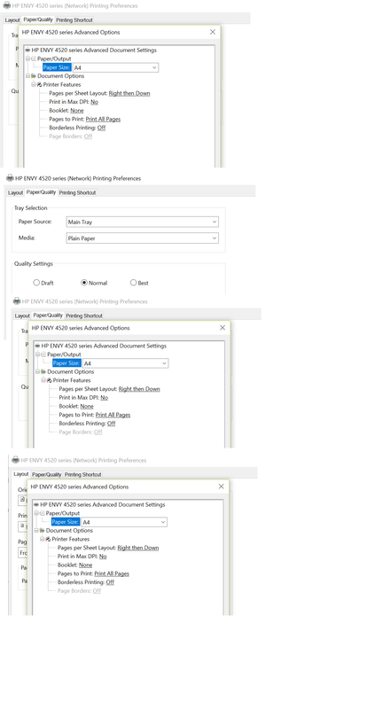

Making color copies is ok.
However, in the "control panel/device and printers"; there are no option for color or even greyscale; have looked everywhere including in "advance".
Hi @csloh,
Thank you for your reply, I'll be more than glad to help you.
I understand that the issue still persists after following the steps provided in the previous interaction.
This issue could occur if the drivers are not installed properly.
Let's go through a few steps to uninstall and reinstall the drivers:
Step 1: Uninstall the Drivers:
Please follow the steps provided to uninstall the printer software in the link: Uninstalling the Printer Software (Windows)
Also, please follow the steps provided below to completely remove the printer software from printer properties.
Steps to remove printer driver files from Print Server Properties:
1. Open the Print Server Properties dialog window by doing any one of the following:
(a). Press WINDOWS-R on the keyboard to bring up the Run window, type in 'printui /s /t2' (without the quotes), and then press Enter or click OK.
(b) From the Start menu or the Start screen and open Devices and Printers. Select any printer and then click "Print server properties" at the top of the window. Click on the Drivers tab.
2. Select the printer driver you wish to uninstall.
3. Click the Remove button.
4. Select "Remove driver and driver package" and click OK.
Step 2: Download and install the Drivers from the link: Full Feature Software and Drivers
Let me know if this works.
You have a good day ahead.
Rainbow23 - HP Support.
