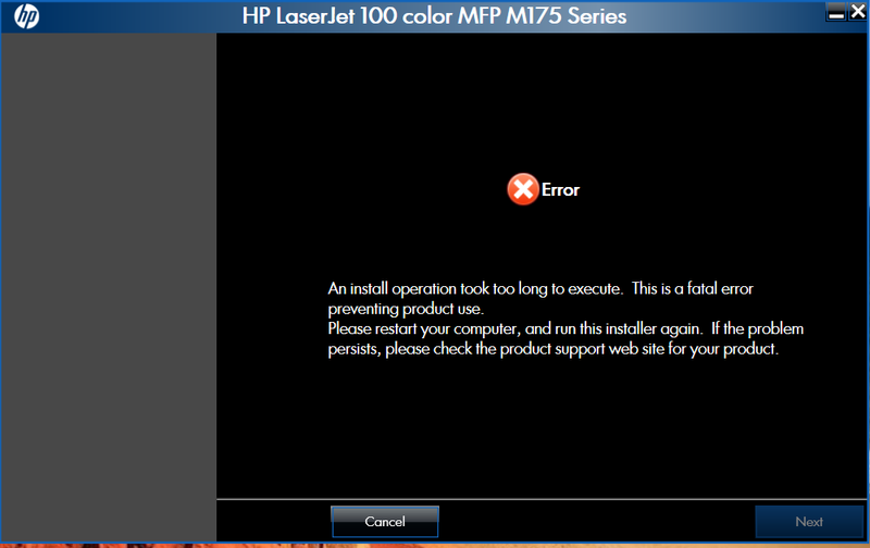

Thanks for the info, but I don't think I have the same software. I am adding some screenshots.
I tried the process a few times, always the same result. 15min to go from 1 to 99%, then another 15min at 99%, then the error message.
I ran the Dr utility and did something - updated the software - but nothing changed.
