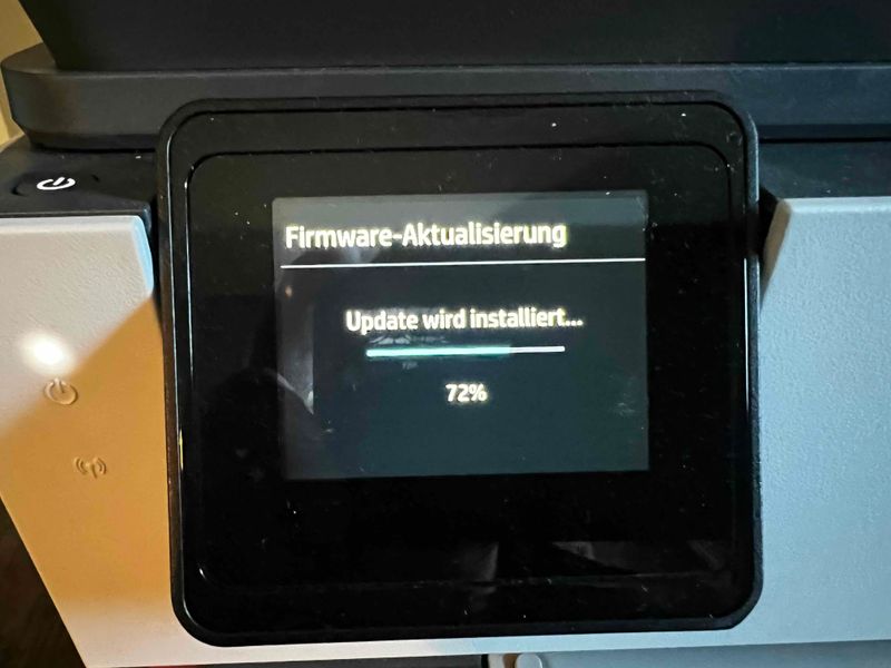

On a side note:  I got this during the update process (via USB as well as via the HP Firmware updater utility) [at 72%]. But in the end it said update successfully.
Update running:
Error message:
Firmware update performed successfully (this was also mentioned in the HP firmware updater utility):
Best.
