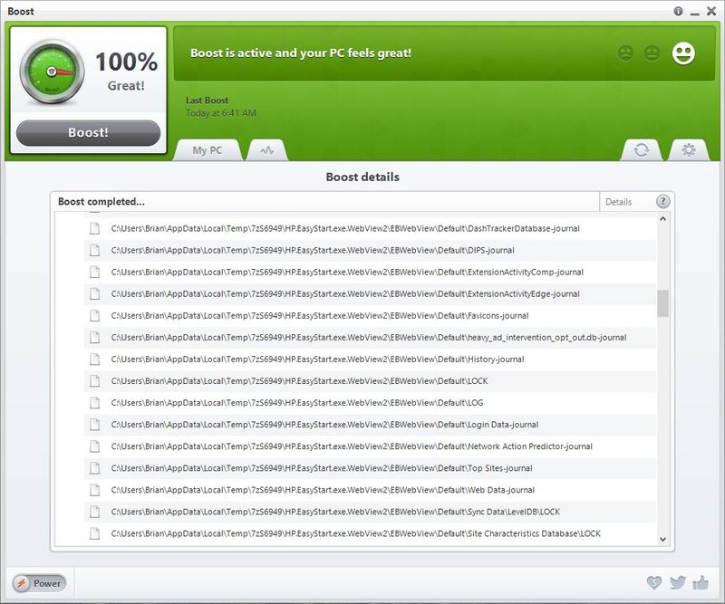

Maybe some of the problems with this over-thunked printer software has to do with what's being forced onto my PC's drive.  These are just SOME of the files Boost By Reason removed from my PC because they're considered spy-files (not my term).
  It scares me that these spy-files were placed onto my PC.It scares me that these spy-files were placed onto my PC.It scares me that these spy-files were placed onto my PC.It scares me that these spy-files were placed onto my PC.
