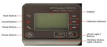

  1. From Home screen press Back/Cancel/Back/Back Buttons, in sequence.
  2. Press OK to enter Support Menu (Selection Button 2).
  3. Press Selection Button 3 for Reset Menu and press OK (Selection Button 2).
  4. Press Selection Button 3 for Partial Reset and press OK (Selection Button 2).
  5. Wait for unit to Power Down/Turn Off.
  6. Press Power button to turn the Printer On.
