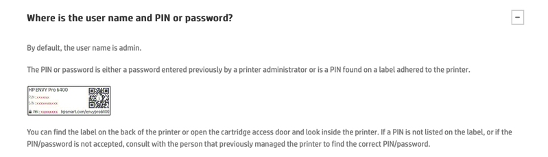

With HP Laser (Not Laserjet) Printers, how can I find the EWS Administrator password to log in to the EWS Page of the printer?
Answer
With previous firmware versions, the default username is admin (all lower case) and the default password is blank
With the latest printer firmware, the default username remains admin (all lower case), but the password is the WPS PIN Number.
To locate the WPS PIN Number, print a Network Configuration Report and locate the PIN Number within the WPS Information section.
Here is how to print a Network Configuration Report report for the different HP Laser printer models:
