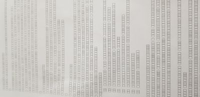

477DW prints frames and question marks instead of text
HP PageWide Pro 477dw
macOS 10.15 Catalina
After the recent firmware update (MAVEDWPP1N001.2127A.00) all text prints are just frames or question marks. Even with the most basic fonts.

I am having the same problem today, specific to Microsoft Word.  I can print other papers completely fine.

We are experiencing the same thing, and it is predominantly with Microsoft Word, though some PDF's (generated out of Microsoft Word) seem to be doing the same thing.

I just spoke to someone at HP support (on the phone) and he told me that the problem is actually on Apple's end, in that they essentially block the firmware update which is why it is printing the way it is. He said Apple are working on it in the background as we speak so hopefully will be resolved soon...
I just tested exporting the file to be a PDF rather than a word document which did work, so hopefully that is a short term solution.

It goes wrong when you try to print true AirPrint if u use the HP software itself as PPD then it is working. Problem is only you can't download the old pod files anymore, because all goes to the "smart" HP software, Where can i Download the "old" drivers ?
I succesvolle installed the old PPD files i had on a other computer that works ! But i don't ave a installer to install the full suit of the software. So the icon is now missing and some messages about not complete software is installed.

I have connected via IP address and chosen the Generic printer.
This can get us printing again
BUT it is not a viable solution... We can still not scan to email, or anything else.

I have the exact same problem printing from Word to the 477dw.  Problem appeared overnight with no configuration changes.  Can print the same document(s) from the same machine with the same software to my other HP printers with no problems.  Can print PDFs and web pages with no problems.  Hard to believe it's an Apple or Microsoft problem since I can print to every other device normally.
