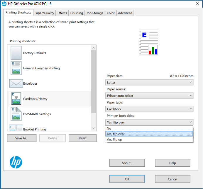

Sorry for the delay, I was out of town yesterday. I have never had issues printing double sided with the Officejet Pro 8740 running on Windows 10 x64 here. I went into the driver to take some screen shots to show the settings and found that I could no longer change any driver settings. This may have been due to some issues introduced in a recent Windows update.
At any rate, I resolved this as follows: go to the Devices and Printers folder. Right click on the Officejet 8740, select Printer Properties, Ports. Note which port the 8740 is using, then Cancel. Next right click on the 8740 and select Remove Device. After the device is removed select Add a Printer. Select your printer, or if your printer does not show up in the list select "The printer I want isn't listed", Next. Select the port and allow the Windows to select the correct driver. If Windows asks to replace the current driver say OK.
Once the printer has been installed right click on the 8740, Printing Preferences. Select your printing shortcut and select Print on both sides: set this to "Yes, flip over" (for left side binding) or "Yes, flip up" for top binding, OK. You can also set this in the Finishing tab.
I notice the setting is available even for cardstock, although the printer does not officially support this.
