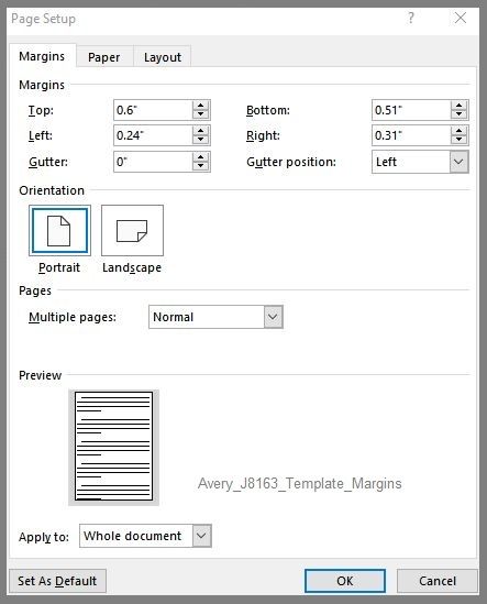

Word > Document > Open Template > Layout > Margins > Click on last entry "Custom Margins"
Avery_J8163_Template_MarginsAvery_J8163_Template_Margins
The top margin is slightly different from the bottom margin and the left-right margins are different from one another, too.

The left-right margins in the template are within the (margin limitations) tolerance as are the top-bottom clearances.  In general, assuming the margins are supported in the printer, it is not necessary (nor warranted) to change the Custom margins set in Word.  Having said that, if the file type has been converted (.doc to .docx), the Word generated Custom margin setting created for the template  might actually end up being incorrect when printed.   ?  Best advice:  Avoid "converting" the template document .doc into the .docx format.
