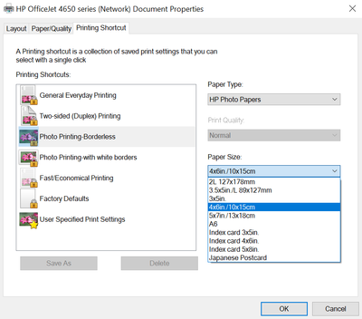

I've used the shortcut to print borderless, but it only gives me certain size options (not including A4) as shown here:

I can't seem to find a way to print borderless in this size so far, at least not through the settings windows I know about. Is there anything else I could try/what could be the problem?
