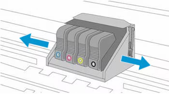

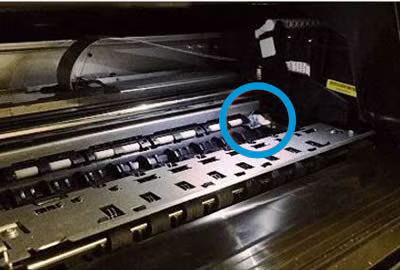

Check for obstructions in the carriage path
Clear obstructions from the carriage area inside the printer.
  • With the printer on, disconnect the power cord from the rear of the printer.
  • Open the door to access the carriage inside of the printer.
  • Look in the carriage path for debris such as crumpled paper or dislodged labels, and then remove any that you find.
  • Use your hand to move the carriage to each side, making sure it moves freely. If the carriage is stalled or docked to one side of the printer and you cannot move it, continue with these steps.

The issue began after I replaced the black ink cartridge. That's when the problem with printer or ink system message appeared. I reseated the new cartridge several times and reset the printer multiple times. There is no obstruction on the printer carriage rod and when I reinstalled the depleted cartridge, the same replace ink cartridge message appears. I also remove the ink cartridge carrier and checked for debris and damage. I also tried a different full cartridge and still the same message. There must be a contact or some other physical issue with the black cartridge port.
”言籌,쭈=한-墨 `
