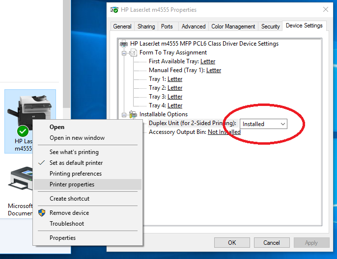

In your "Devices and Printers" folder in Windows 10. Right Click on the printer and select "Printer Properties", then check the "Device Properties" tab and see if it shows the duplex function there.

Thanks a lot. I got into Device Settings (I assume that's the same) which says that the Duplex Unit for 2-sided Printing is not installed. Is there a way I can install it?
Usually, if you just click on that duplex option you'll get a drop down box or it will change to installed. Depending on the operating system rights, you may need an admin account to change driver settings.
I dont have that particular driver installed, but it should look something like this

I followed your instructions and it worked perfectly. The word "manually" had been deleted from the Finishing tab, so that was a clue that a change had been made. I did have to restart the computer to make the change take effect.
