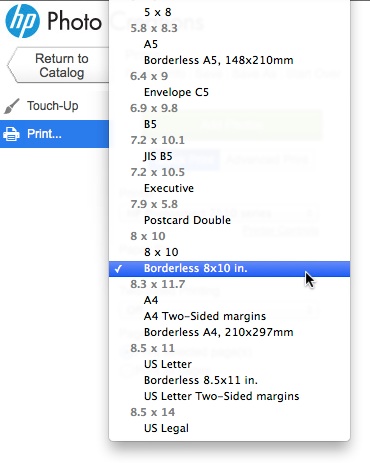

Hi Paul.
You may need to select borderless printing in the advanced settings of your printer. Please see the image below for an example of that on a Photosmart 7510. In HP Photo Creations, you can access your printer's advanced controls by clicking Printer Controls on the printing screen.

Thank you Rocket.  I do not get the "Printer Features" shown in your screen capture and none of the other settings even offer the borderless printing as an option.  I will use the link you provided if I can't get it to work under the Administrator account on my home computer.  I don't know if everyone does this, but I keep a separate account for Admin and one for general use to minimize viruses and other hacking.  The only thing I can think of at this point is that I have not given permission to select that option to my general account, yet.  Failing that, I'll contact HP support.

Hi Paul.
You're right: The 7612 does promise borderless printing:
http://store.hp.com/webapp/wcs/stores/servlet/us/en/hp-officejet-7612-wide-format-e-all-in-one
So if you can get to the advanced panel, you should be able to turn borderless printing on. You may be able to select borderless printing directly from the HP Photo Creations  paper menu as well.

Thank you for the confirmation.  I am able to access the Advanced Panel, however, there is no selection for borderless printing of any size.  I have tried under the Admin account as well as under my normal account and I cannot find any setting that would allow this.  I wonder if the borderless printing is only for OSX?
