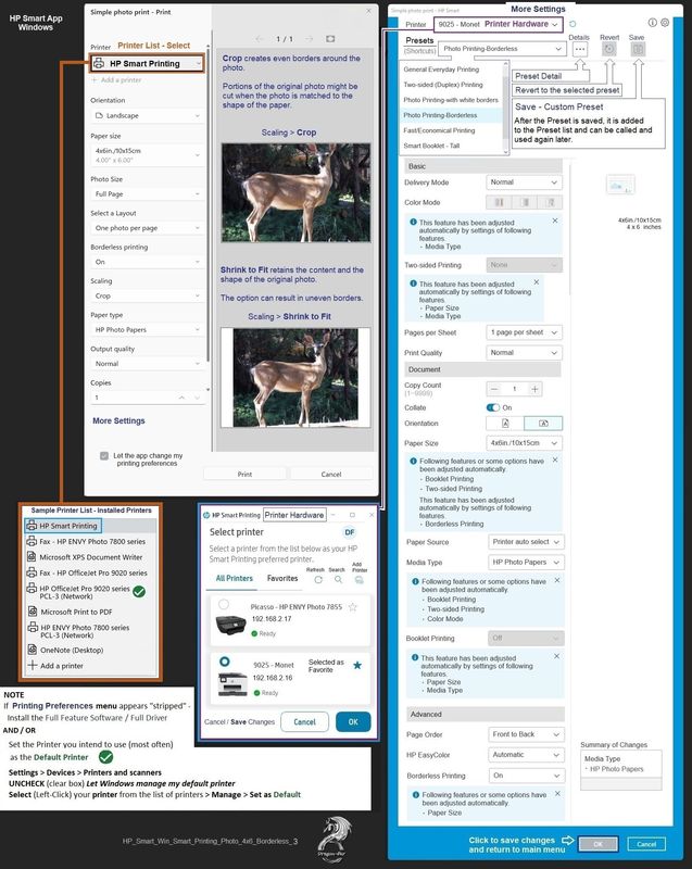

For example, if you have a DeskJet printer, the model series does not support Borderless as a feature.
AND
DeskJet printers (at this writing) require a larger margin (12.7mm) at the bottom edge.
On those printers where Borderless is supported, there are frequently limitations based on paper size and type.
For example, some printers only support Borderless printing on Photo Paper.
Borderless might not be available on all paper sizes and / or paper types.
The application or software you are using to configure the print job impacts how the job setup reacts.  The application cannot change what the printer can do -- The app / software might respond with a reason for the conflict - for example, unsupported paper type, wrong paper size, content type.
General Example - HP Smart - Windows - Simple Photo Print - 4x6"
HP_Smart_Win_Print_Photo_4x6_All_5HP_Smart_Win_Print_Photo_4x6_All_5
General Example - HP Smart - HP Smart Printing queue - Job Setup
HP_Smart_Win_Smart_Printing_Photo_4x6_Borderless_3HP_Smart_Win_Smart_Printing_Photo_4x6_Borderless_3
